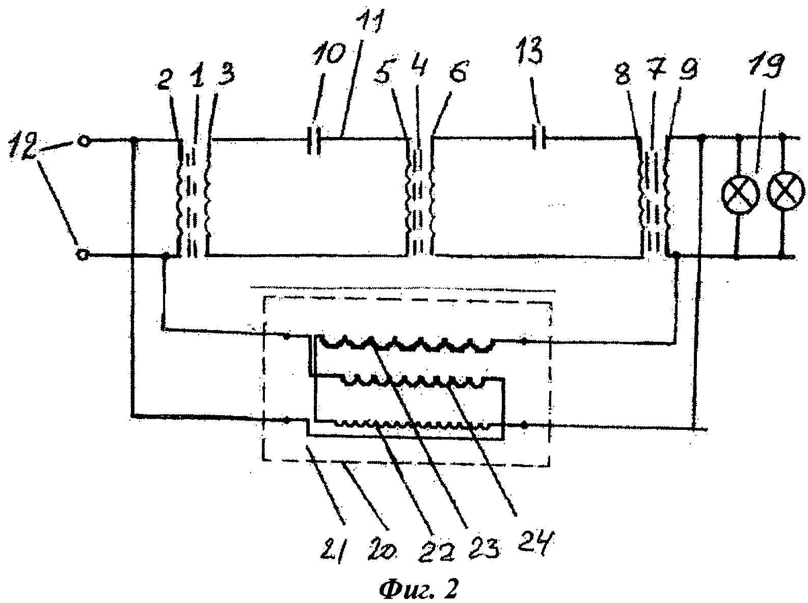

Here is the Zero transformer of Utkin at the end of the page.
https://samlib.ru/u/utkin_w_m/exper-2.shtml

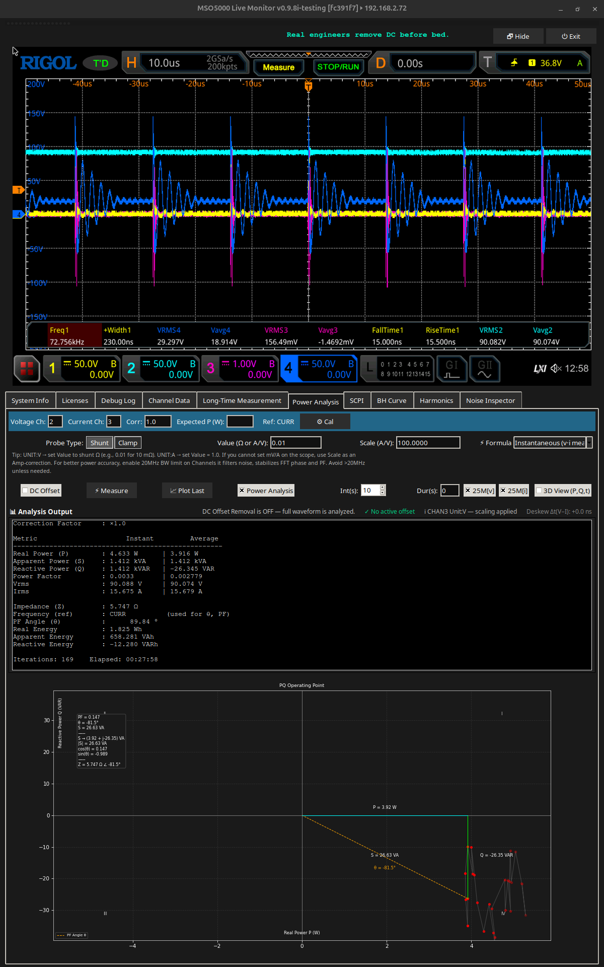

now this is result from power analysis
i use 4W +/-10% for reaching 1,4kVA in the system. this is because the current is highly oszillating but has a low Iavg value. and there is no heat at all. everything is room-temperature.
CH1 is input pulse, CH3 is current on low side of power supply. CH2 is voltage from power supply.

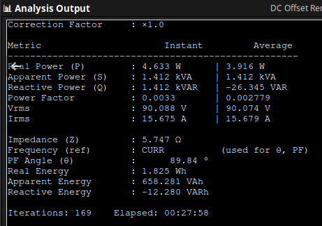

The first image is difficult to read i cannot zoom in.
If I'm reading correctly, you have an instantaneous power of 4.6 W
and an real (average) power of 3.8 W ??
baerndorfer posted this 08 October 2025
'Instant' is the last data snapshot. In this run i did 169 iterations and 'Average' is the value we should look at.
