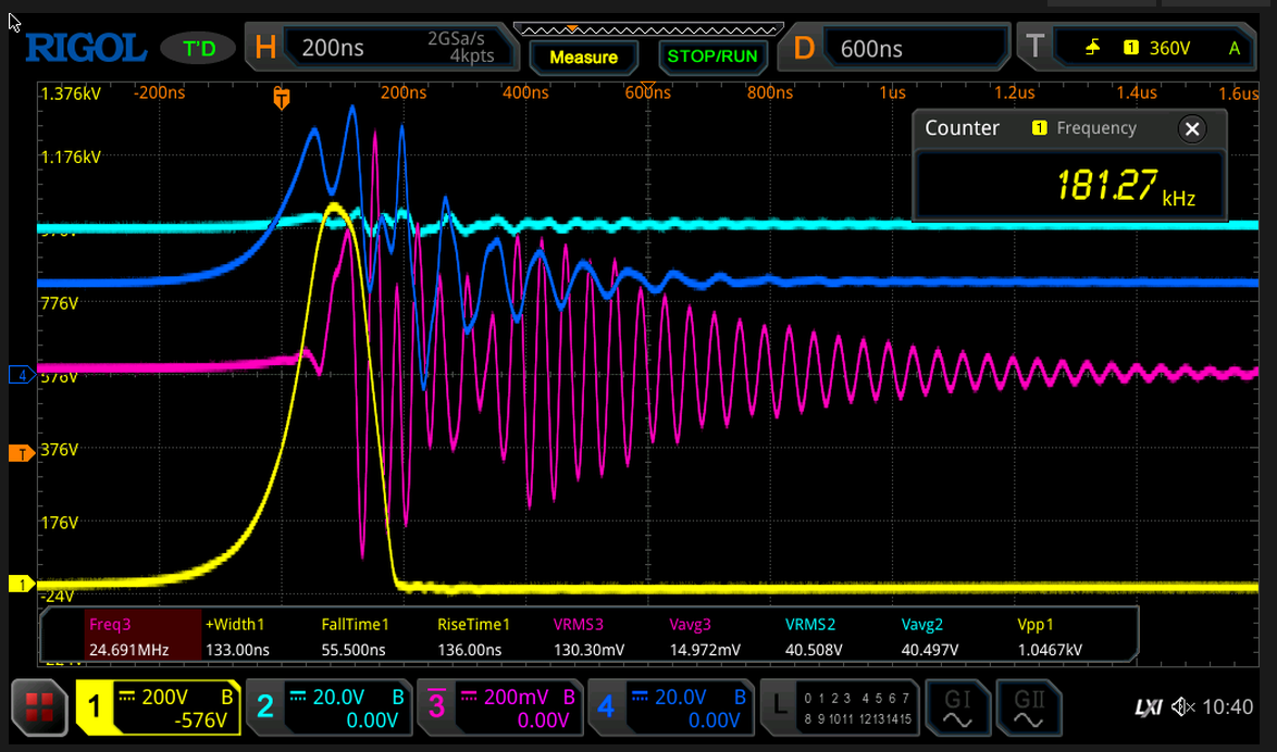

i do battery charginge with analoge pulsing circuit. like the famous ReEmf-charger invented by some guy from the netherlands i think.
here is a screenshot from the action..
CH2 is positive pole from battery and on CH4 is minus pole from battery. when the pulse happen (ch1) the polarity of battery changes. the negative pole is more positive, than the positive pole itself. by doing so the battery gets 'refreshed' or can 'repair' itself. CH3 is the current which is highly reactive.

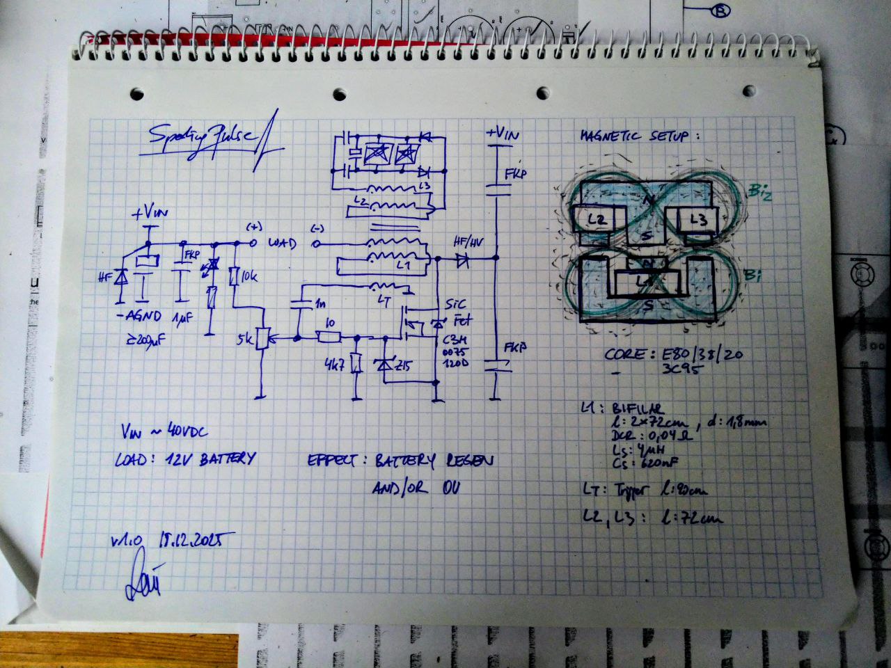

this is my circuit if someone like to replicate.

Baerndorfer,
I'm putting your charger on my wish list. Have you made any circuit boards for it?

i made some pcb's for testing but i have no final version. the bigger 'problem' is building a proper housing for e-core system.
