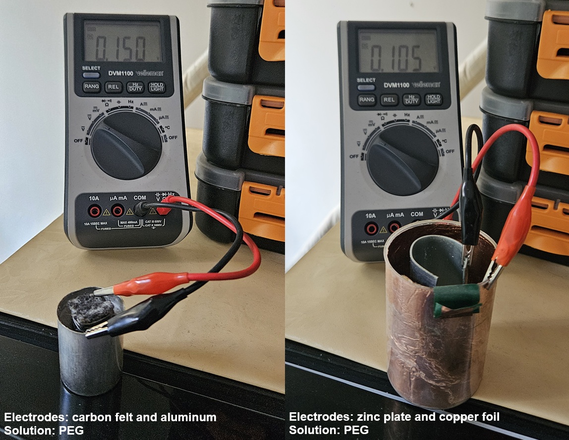

I ordered some conductive carbon felt from China:
Soft Battery Electrode Conductivity Graphite Felt High Temperature Carbon Fiber
As Relaxa is not available in Europe, the closest product I found available and I ordered is this:
Effecol 3350 Epsilon Health, 12 plicuri x 13,3 g, S.I.I.T.
Hopefully its PEG 3350 composition is similar to the Canadian product.
I don't have a sheet of magnesium but I have one high-purity Zinc plate I bought for the water-based device (post here).
I'll see how it works with that and I'll try with other metals. If the efficiency will be lower I will search for a magnesium plate.
For now I must wait for the carbon felt, it will take a few weeks to come from China.

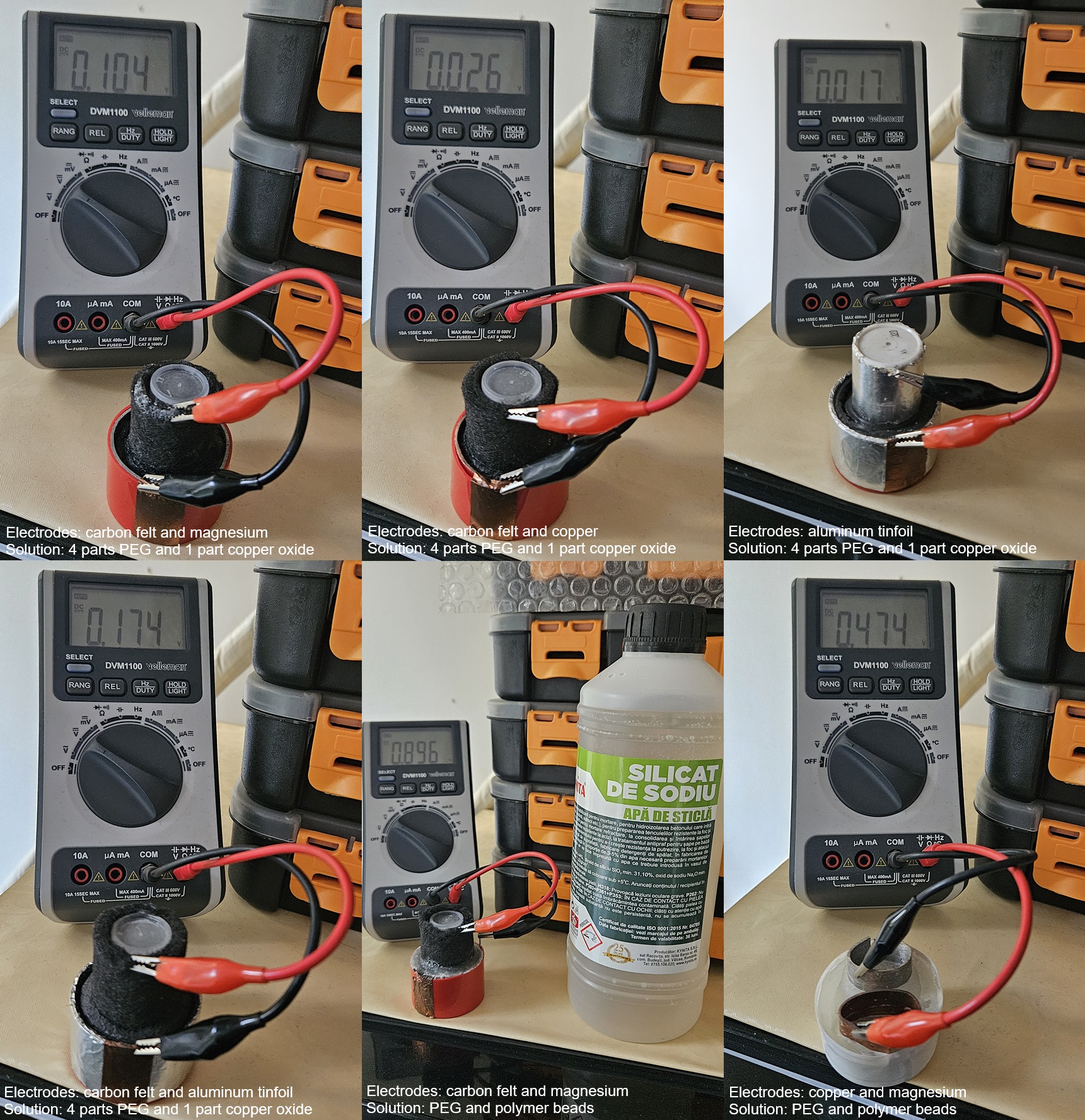

As I said in my post here I come with a status update for my quantum cell replicas.
After one year since they became functional (according to this post) they are still providing voltage (even if they are not powerful as they were one year ago) which I consider remarcable.

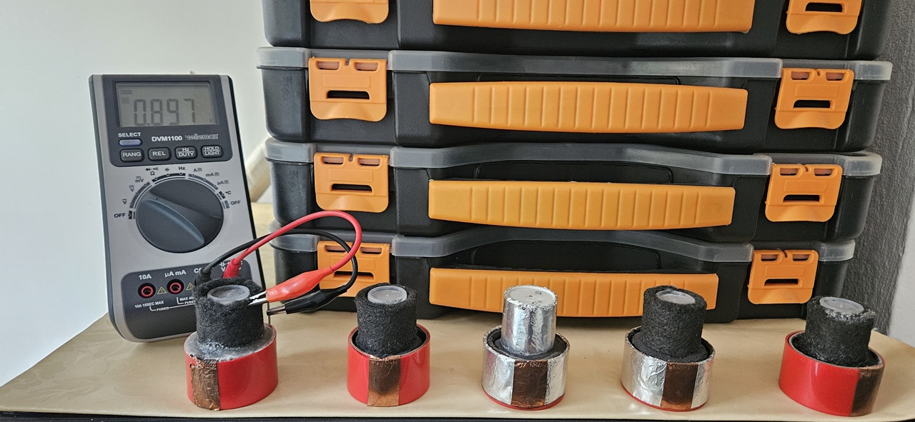

This is how they look now where I kept them under observation:
And just like I did one year ago I'm posting their current voltages.
This is the 1st generation:
And this is the 2nd generation:
I checked them carefully, I didn't found any corrosion signs on any of their electrodes, at least not on the edges of the electrodes where they are making contact with the solidified solution. For now I don't want to break them just to look inside but I guess if inside would be corrosion it would be visible near those edges too.
The most powerful now is the cell made with carbon felt, magnesium, PEG and polymer beads, #5 in the image above.

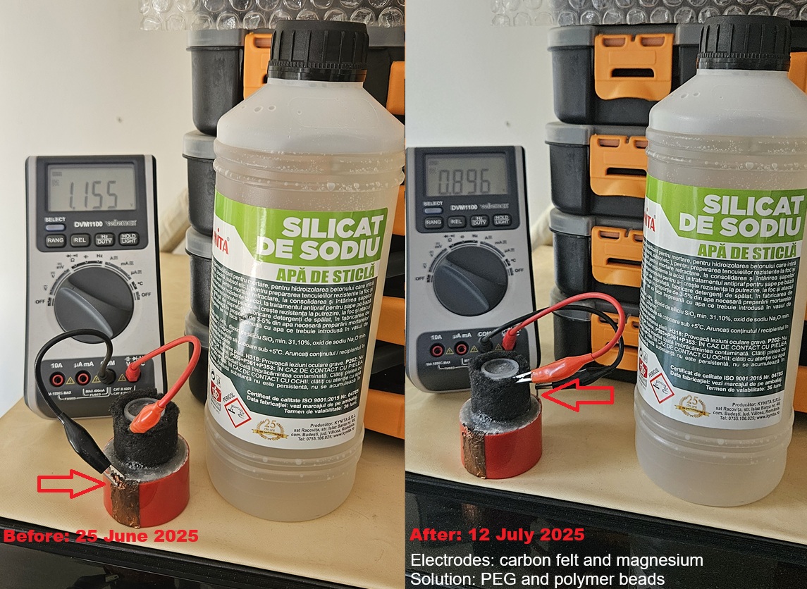

About this one, I think I broke it, so its real voltage should be higher.
Let me explain. About 3 weeks ago it had about 1.15V but I had a problem with the copper foil providing electrical contact to the magnesium electrode. The aligator clips I used in time to connect the cell to the multimeter damaged the foil and the contact was sporadic. Because of that I decided to take a metalic pin and to insert it between the plastic and the magnesium electrode so I can have a ferm contact. Since then cell's voltage dropped to about 0.8-0.9V.
I don't have a explanation about the exact cause of the voltage drop but I have two hypotesis:
  1. The crystal-like core broke in that area when I inserted the metalic pin even if I didn't inserted it in the core directly but on the outside of the magnesium electrode;
  2. That area of the magnesium electrode was exposed to air by the insertion of the metalic pin, before there was no air because the tight plastic wall was preventing the air to have contact with the electrode; that could mean exposing a bigger surface of the magnesium electrode to the air could make the voltage drop ? I cannot confirm this hypotesis right now without damaging the cell so I'll keep it in mind as a hypotesis for now.
These are two photos of the voltage of the cell before (about 3 weeks ago) and now:
So I think the real voltage of this cell is actually 1.15V. If after one year it was providing this voltage it's safe to assume this is its real potential and it's no coincidence that the voltage dropped after I inserted that metalic pin.
But this is not a problem. Because it's nthe most powerful and it's validated in time I'll build another one as the 4rd generation and I'll try to find another solution to have electrical contact to the magnesium electrode, seems the copper foil was not a good idea.
