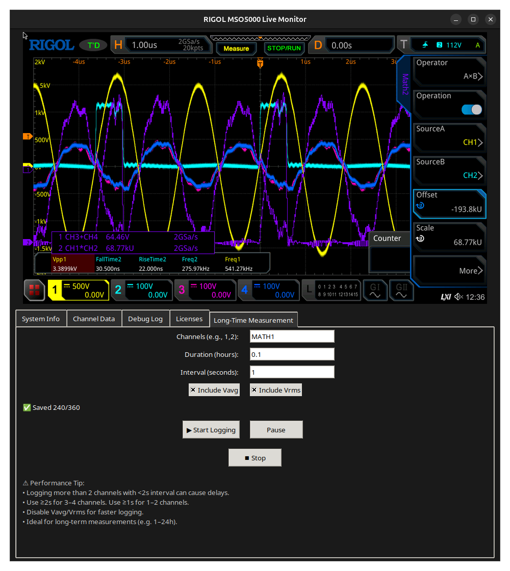

Hi all,
because i was not very satisfied with Web-View from Rigol for my MSO5000 i build my own one.
This tool provides a live view and SCPI-based data extraction from a **Rigol MSO5000** oscilloscope with **hacked firmware** via VNC and VISA (SCPI) interfaces.
The script displays:
- Live screenshots from the oscilloscope (via VNC)
- Channel information including coupling, bandwidth, scale, offset, and probe settings
- Trigger and timebase settings
- Raw waveform statistics (Vpp, Vavg, Vrms) for up to 4 channels
- A scrollable debug log for diagnostics
## Requirements
This script is written in Python 3 and depends on the following libraries:
| Library    | Purpose                            |
| `tkinter`  | GUI interface                      |
| `Pillow`   | Image processing for screenshots   |
| `numpy`    | Numerical processing of waveforms  |
| `pyvisa`   | SCPI communication over TCP/IP     |
| `vncdo`    | VNC client to capture screen image |
### Install dependencies
Make sure you have Python 3 installed, then:
```bash
sudo apt install python3-tk python3-pip
pip3 install pillow numpy pyvisa
sudo apt install vncdo
> Note: On Debian/Ubuntu systems, `vncdo` is often available as a package. If not, install it via `pip install vncdo`.
##How to Use
```bash
python3 rigol_vnc_liveview4.py
You will be prompted in the terminal to enter the IP address of your RIGOL MSO5000.
Make sure:
- The oscilloscope is on the same network.
- VNC is enabled on the oscilloscope.
- The oscilloscope responds to SCPI commands over TCP/IP.
##Hacked Firmware Notice
This script is optimized to **avoid crashing or hanging** when used with unofficial / hacked firmware:
- Timeouts are reduced
- Some known problematic SCPI queries are skipped or blacklisted after failure
##Screenshot Path
By default, screenshots are saved temporarily at:
/tmp/oszi_screenshot.png
##Customization
You can adjust these in the script:
- `INTERVALL_BILD`: How often to update the screenshot (seconds)
- `INTERVALL_SCPI`: How often to fetch SCPI data (seconds)
- `WAV_POINTS`: Number of waveform points to request per channel
##License
This project is for **personal use only**. Use at your own risk. Not affiliated with Rigol Technologies.

baerndorfer posted this 15 July 2025
finally i made MATH-channels accessible within Live Viewer.
the new version with clean installation instructions are on github

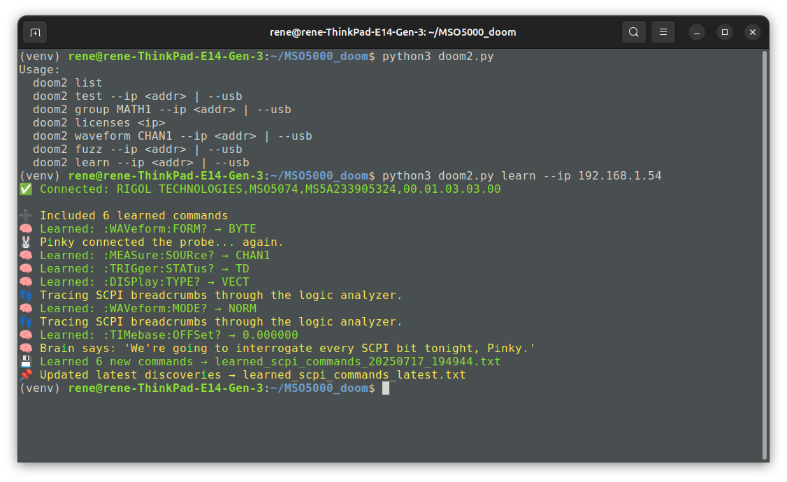

baerndorfer posted this 17 July 2025
found out, that connecting via usb cannot transfer the image, but can transfer data. i will see how this can fit in the ongoing development.
because things get complicated i made a SCPI toolkit for Rigol MSO5000 series. goal is to find all possible SCPI commands. this tool works via LAN and USB.
when i found new interesting commands i will integrate them in the Viewer.
Actually i published v0.9.3 which got a lots of upgrades in background.
Doom -> https://github.com/ariDev1/MSO5000_scpi_doom
Viewer -> https://github.com/ariDev1/MSO5000_liveview

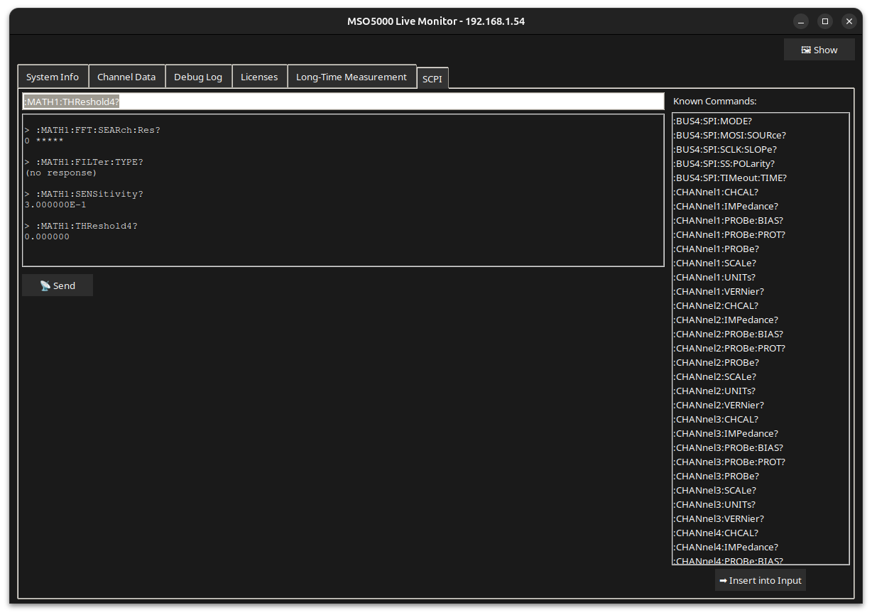

baerndorfer posted this 19 July 2025
## v0.9.4 (2025-07-19)
- ๐Ÿงช **New SCPI Tab**
  - Added a dedicated SCPI tab with manual command input
  - Response output area with scrollback and timestamped logs
  - Optional right-side command list (`scpi_command_list.txt`) lets users select known SCPI commands
  - Double-click or “โžก Insert into Input” button to load from list
  - Handles I/O errors safely and logs all SCPI activity
- ๐Ÿงฑ **UI Improvements**
  - Fixed vertical overflow in SCPI tab — output box no longer hides buttons
  - Sidebar list resizes correctly with window
- ๐Ÿž **Debug Log Integration**
  - All SCPI commands and errors now appear in the Debug tab
  - Uses `log_debug()` for traceability
- ๐Ÿงผ Minor cleanup:
  - Removed layout duplication from button handlers
  - Improved resilience against missing files (e.g., `scpi_command_list.txt`)
with this new version you can throw scpi commands to the scope and see if it respond. this is great for testing...

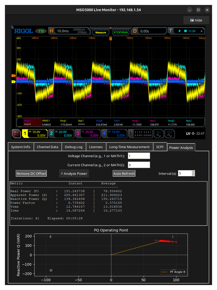

baerndorfer posted this 20 July 2025
the new version will have a Power Analysis. Goal is to perform better than the build-in Rigol stuff actually i am pretty impressed with the result.
the script grab RAW data and compute it accordingly. we can see where the 'load' is placed inside the 4 quadrant plot which is important.
when it runs solid and data can be exported in csv for further processing i will release this new version.
if you have ideas please tell me
