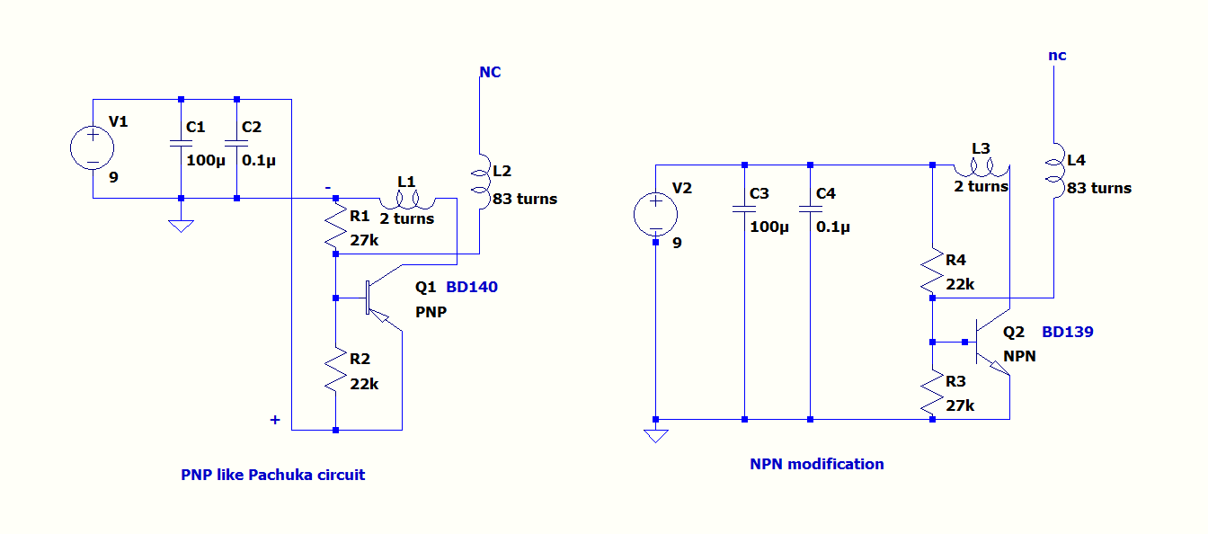

this is the circuit from the video above. thought it should be inside this thread. thx jagau!
Jagau posted this 15 March 2026

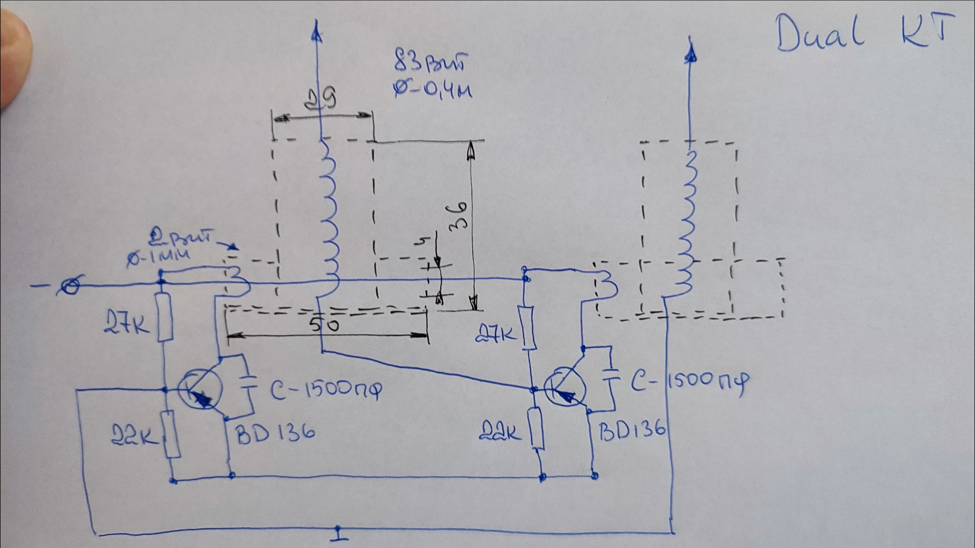

Yes, Bearndorfer, that's the complete circuit for the double Kacher.
And for those who want to do it with an NPN transistor if you don't have a PNP transistor:
The power supply circuit for making a half-circuit becomes like this: just place 22K on collector side.
and it works very well with a half-circuit as well, having tried it.

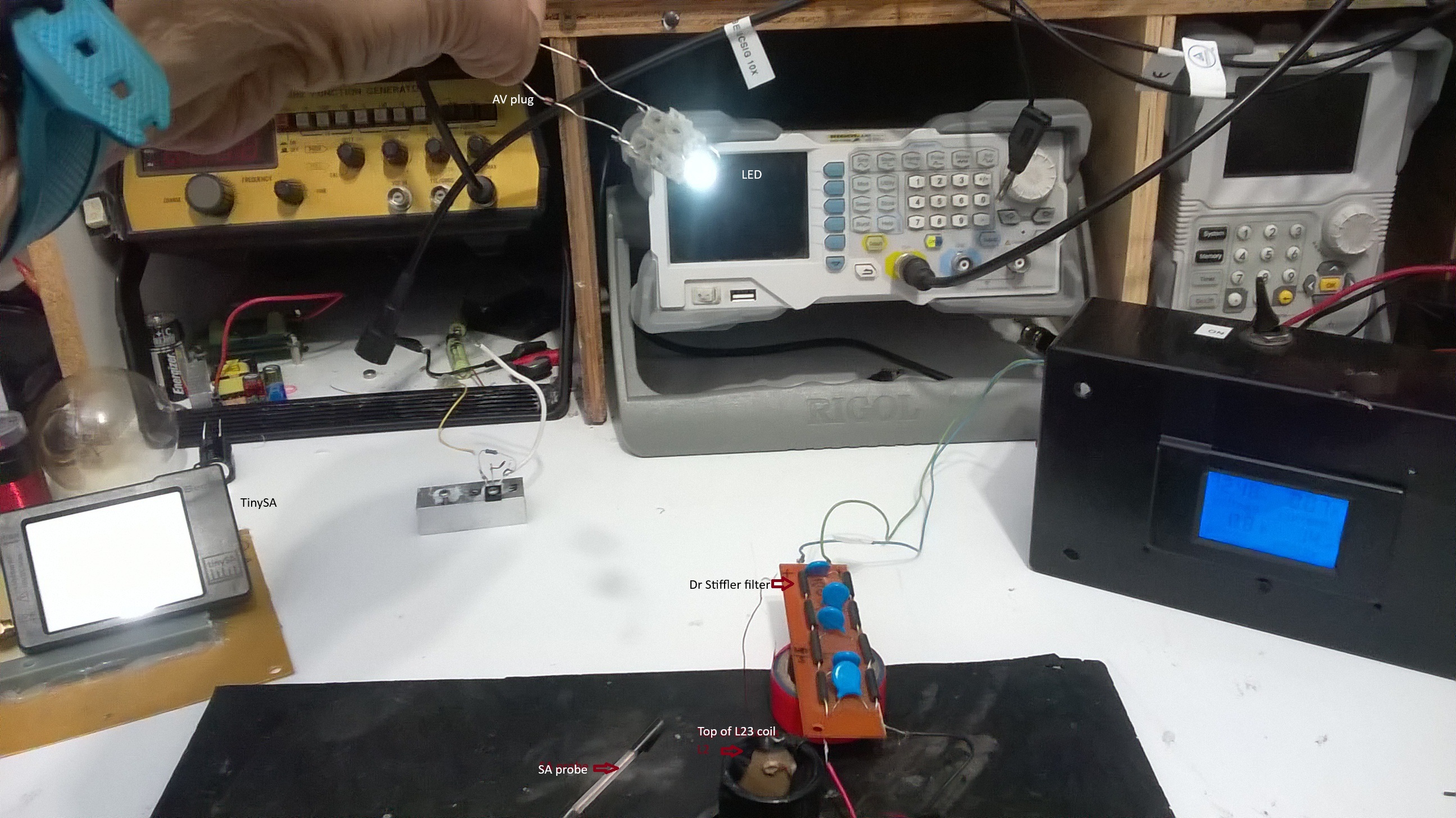

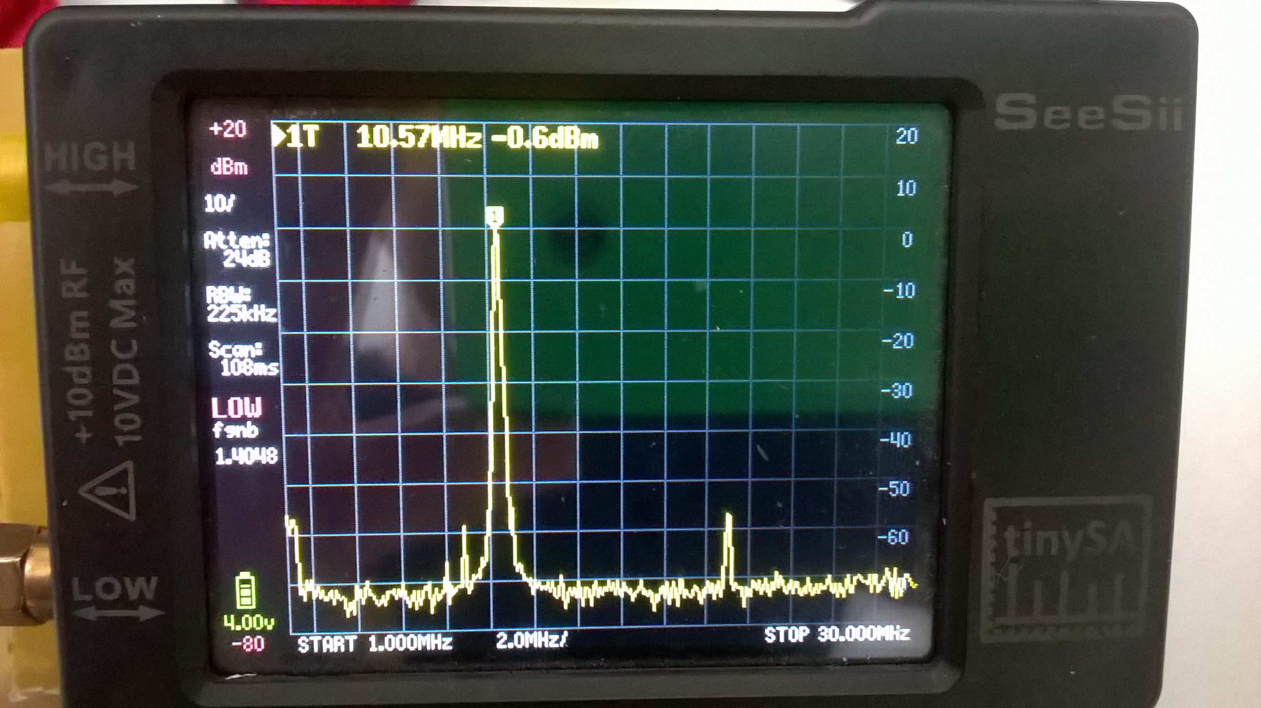

On my TinySA I have a solid 10.57 MHz at near 0.6 dbm  with this configuration.
Remember how Dr. Ronald Stiller attached importance to this frequency when he spoke about coherence!
An excitation of the ether at a distance of more than one foot causes the LED to light up very brightly on AV plug between my fingers, for an input consumption of a few milliwatts.
Actually, it's a nice little, very simple circuit that adjusts itself to the resonant frequency of L2, and I'm learning to discover it.
