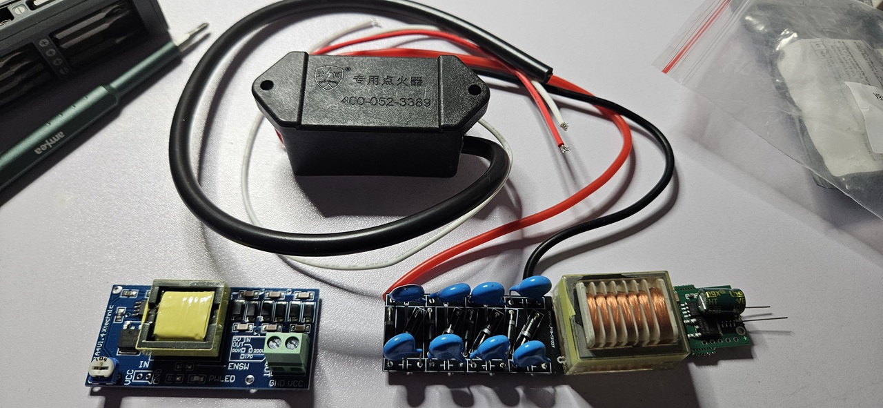

For the DSE experiment I aquired the following:
  • DC High-Voltage Boosters:
    1. DC 5-12V To 8X Voltage Booster And Arc Generator (can work continuously 2-3 hours);
    2. DC 5-12V To 20KV Voltage Booster and Arc Generator
    3. DC 5-12V To 300-1200V Adjustable Voltage Booster;

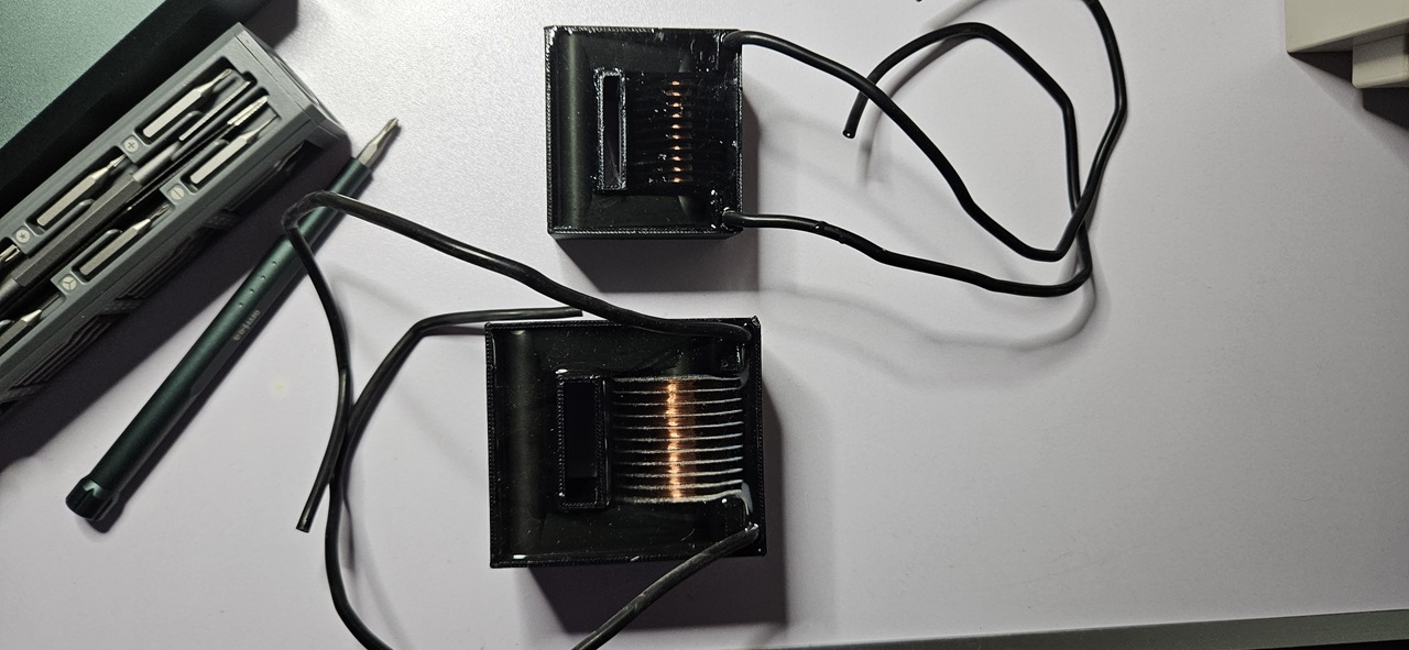

  • Step Up/Down High-Voltage High-Frequency Customizable Transformers:
    1. 30KV 200W High-Frequency Customizable Transformer;
    2. 30KV 500W High-Frequency Customizable Transformer;

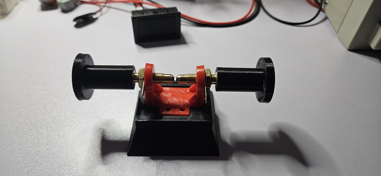

  • Spark-Gap:
    1. Tungsten Adjustable Spark-Gap (aquired not from China but from Norway);
These are the items I aquired for my DSE experiment.
I know the voltage boosters are made to produce high-voltage arcs so I cannot use them to power DSE's input coil directly but on their output I can put DSE's input coil and the spark-gap so in that way I will have high-voltage in DSE's input coil without burning these high-voltage generators. At least that's the plan I've made before deciding to buy them, I'll see how it will work.
About the customizable transformers I can build their missing coil as primary or secondary depending if I want to use them for stepping-up the voltage in my current DSE configuration or as stepping-down the voltage from in a different configuration if needed. That's the second plan I've made before deciding to buy them, I'll also see how that will work too.

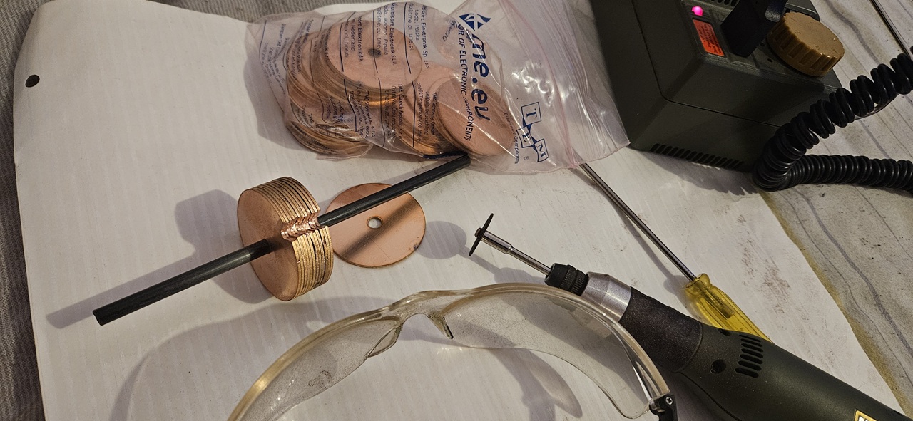

Just a small update, I have a solution to avoid the short-circuits beween the disks and also the latest problem of soldering wires on the aluminum disks which doesn't work with the soldering tools and solder used in electronics. This last one problem (soldering on aluminum) is something I didn't thought about and in the previous attempts I discovered the soldering produce cold electrical contacts/connections, they're unreliable.
The new solution required a lot of work: cutting small V-like channels in all 120 aluminum and copper disks and then execute precisely positioned holes in each of them. It's a lot of minutious work and I pray the 3 remaining cutting disks I have will resist without breaking until I complete this operation:
The progress is slow but I'm progressing using the chunks of time I have available.
I'll come with more details and photos when the capacitor/collector is ready, most likely the entire work will take days. But considering how long overdue I'm with building this capacitor I think it's acceptable.

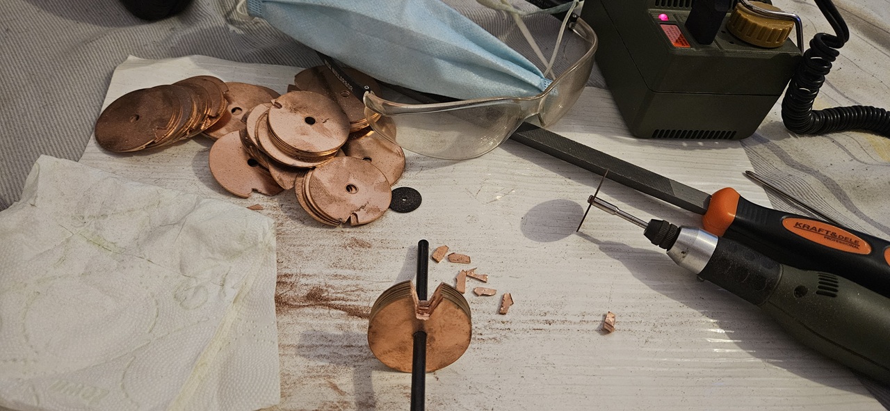

Fighter posted this 31 July 2025
Just a small update.
I finished cutting the copper disks, this metal is eating my cutting disks for breakfast.
The metal is weighty and getting very hot fast while cutting it, I guess that's what the Chinese seller meant by "pure copper".
Unfortunately cutting the V-like channels didn't go well, for some of them the angles were way off and the cuts are not similar and uniform:
I'll try to correct them as much as possible, I have a shipment with more corundum cutting disks and also another shipment with piles (including a triangular pile) on the way for grinding the channels while the disks are together like in the image so hopefully I'll make the channels as uniform as possible.
That's what happens when not having a workshop with proper tools and needing to improvise.
I guess doing the same with the aluminum disks will be easier, I used my cutting disks to easily cut aluminum before and it worked well.

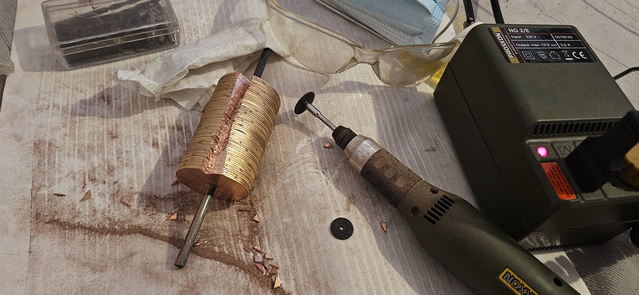

Fighter posted this 02 August 2025
Small update.
Working on the corrections looks good for now, having enough cutting disks doesn't make me stop from work because being worried I'll break the cutting disk and not having reserves like I did before.
The triangular pile is useful in correcting the angles of the cuts and smoothing the edges.
Of course the cuts doesn't look too CNC-ish but still they look uniform and that's good enough for how I planned to build the customized capacitor.
Still a lot of work to be done. After I finish this I must do the same with the aluminum disks and then I must drill a precise hole in each of the 120 aluminum and copper disks.
I must stop now because it's close to 10 PM and I don't want the neighbours to call the police because of noises in the building. 😄
I just wanted to test how to proceed with the corrections and the first results, I'll continue tomorrow.
