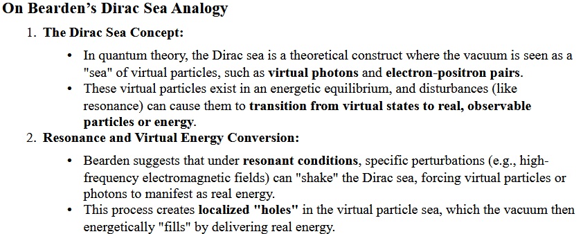

Adding here a section from the document, I think it's very relevant not only to DSE but also to all the devices we're experimenting with here:

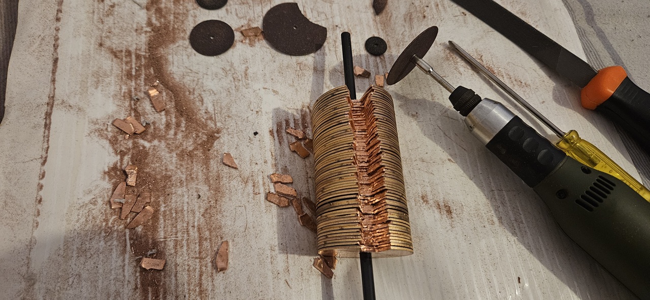

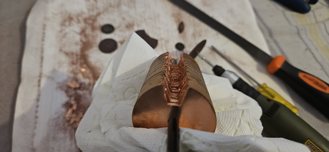

Finished correcting the cuts in all copper disks:
In the process I "consumed" 3 cutting disks plus one broken as you can see in the image.
The cuts are not looking very nice but functionally they are good enough, they'll integrate well in the capacitor:
I still need to smooth the edges of the cuts using the piles, there are some copper fragments attached to the edges.
After this I'll start doing the same with the aluminum disks.
Theoretically cutting the aluminum disks will be easier, the metal is not heavy and difficult to cut like copper.
I'll see how it works, I'll post updates.

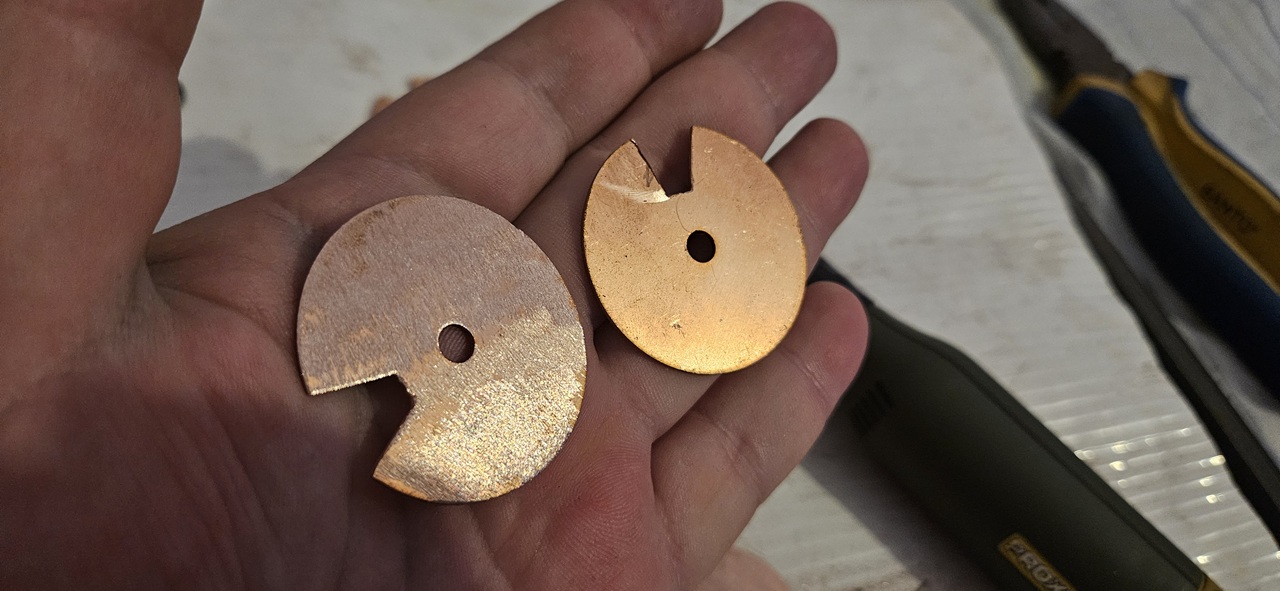

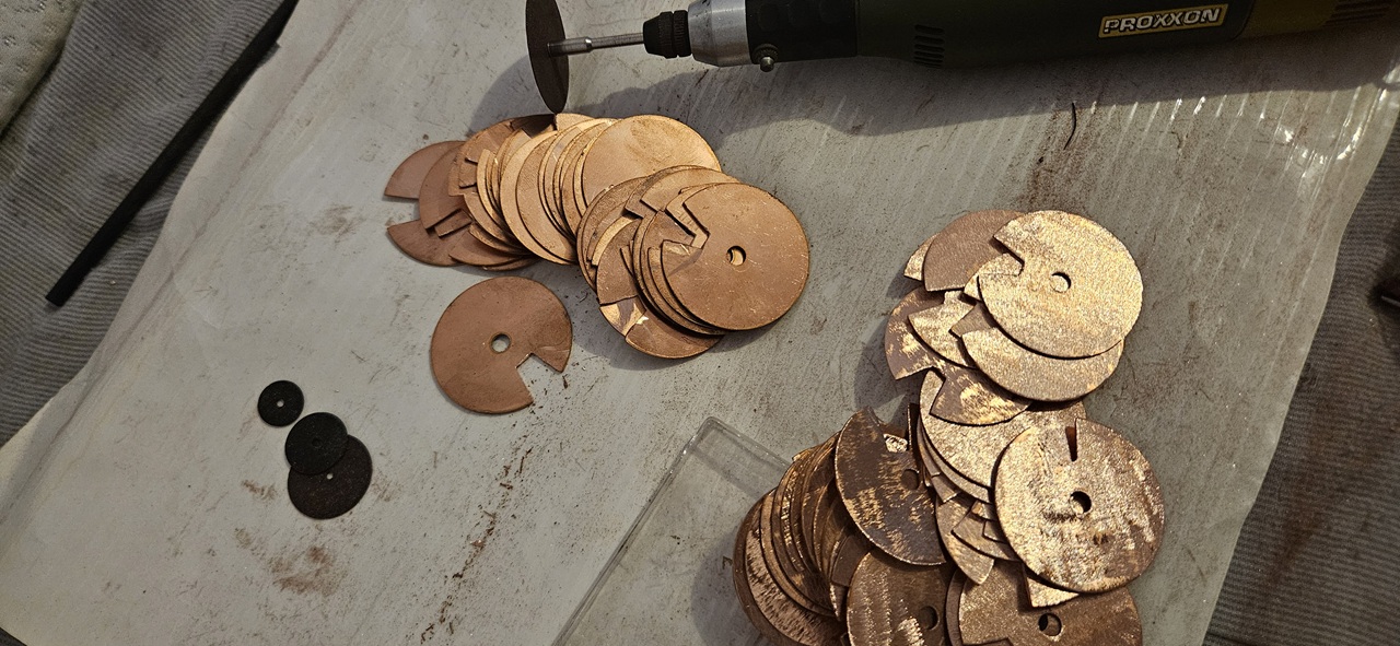

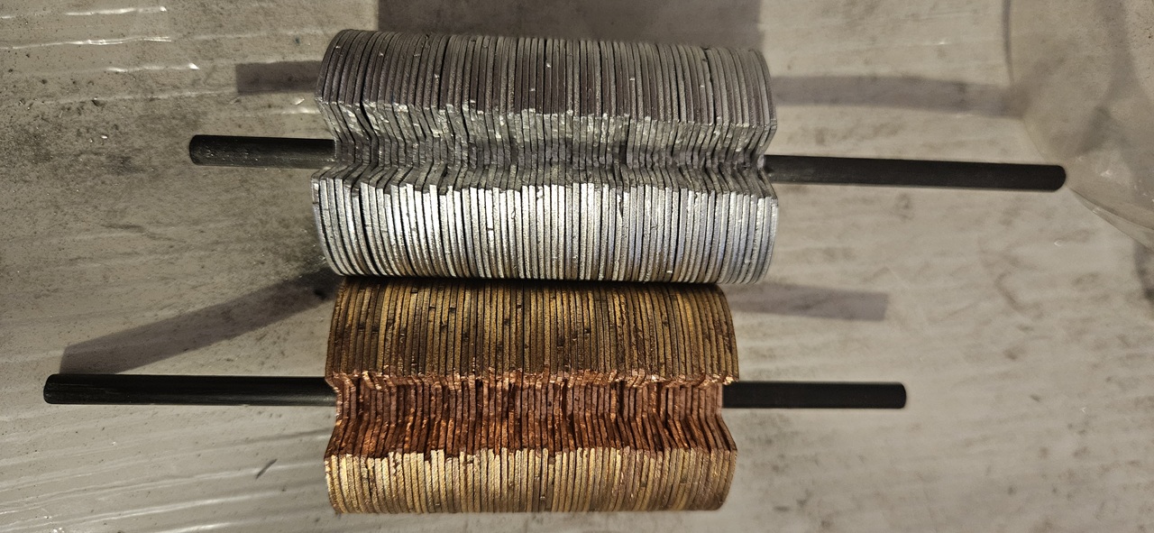

While cleaning the cuts edges from remaining copper fragments I thought it's a good idea to also polish the disks because in time their surface accumulated a thin layer of oxidation:
Made them more electrical conductive:

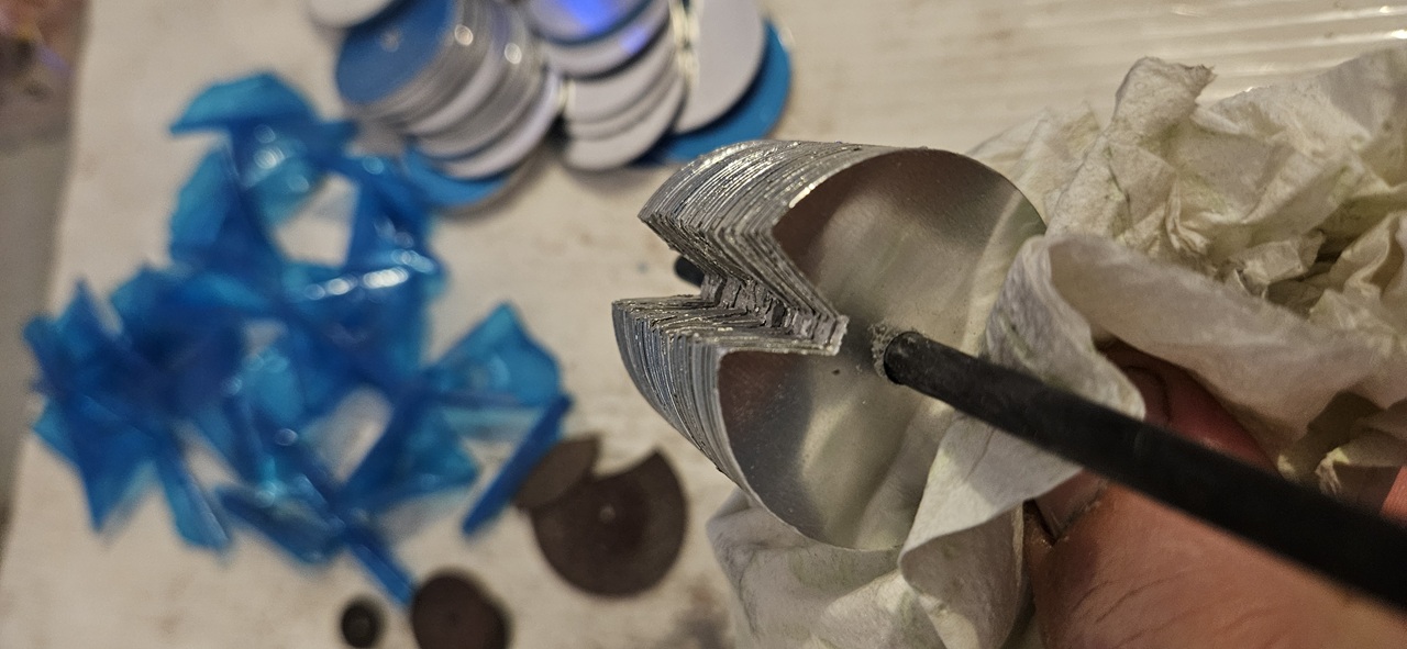

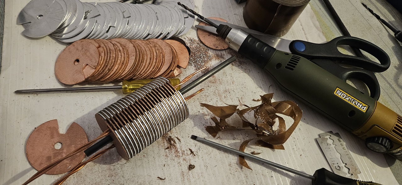

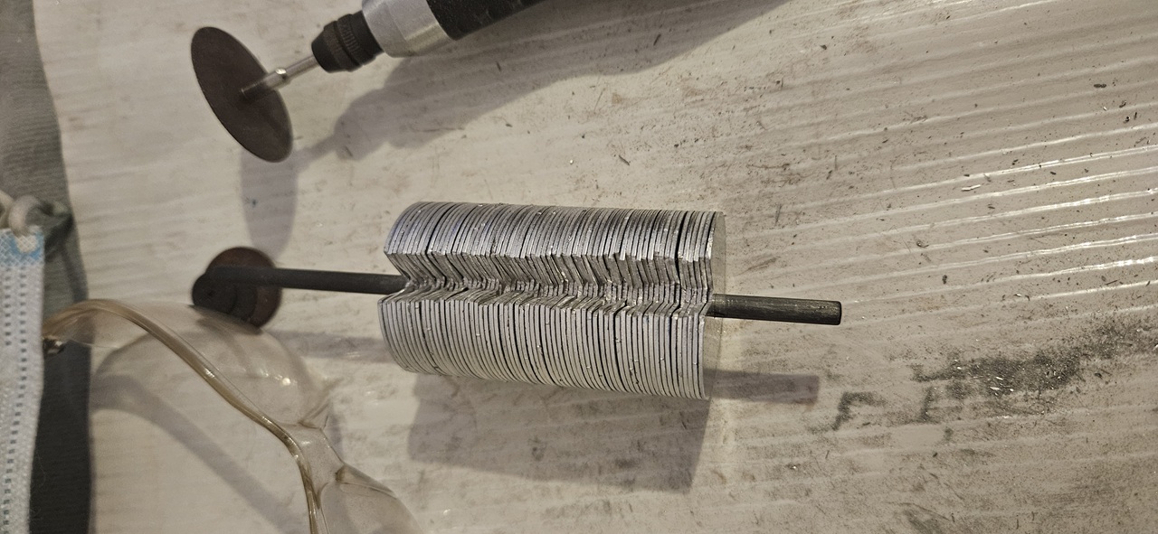

I resumed the work, I performed cuts in 30 aluminum disks, still 30 to work on:
Cutting aluminum is much easier than copper, it's "consuming" less from my cutting disks.
I broken one cutting disk but that's my fault, I tried to use higher rotational speed while cutting.

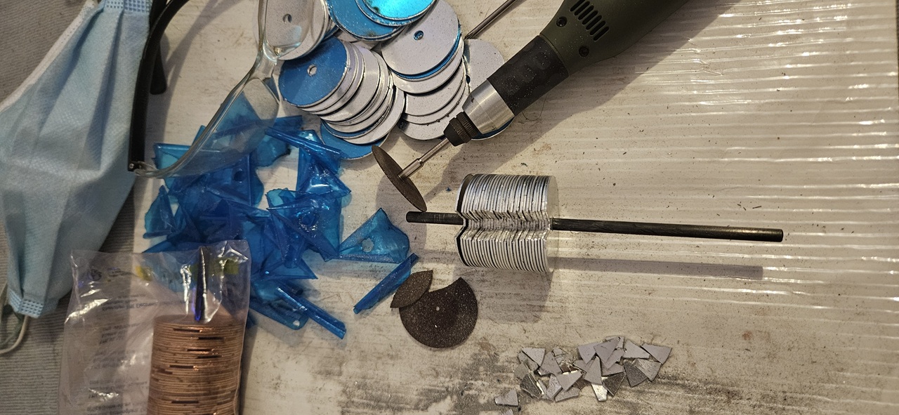

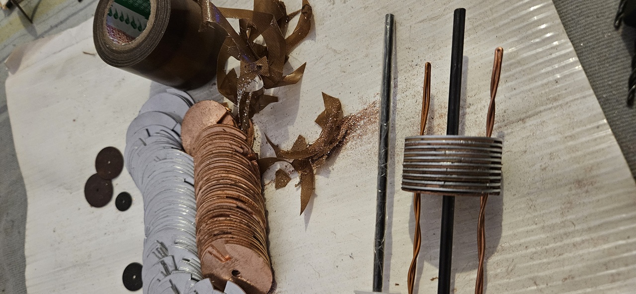

Cutting the aluminum disks is finished:
Seems the Chinese manufacturer added 3 extra aluminum disks (they're 63 instead of 60 as I ordered):

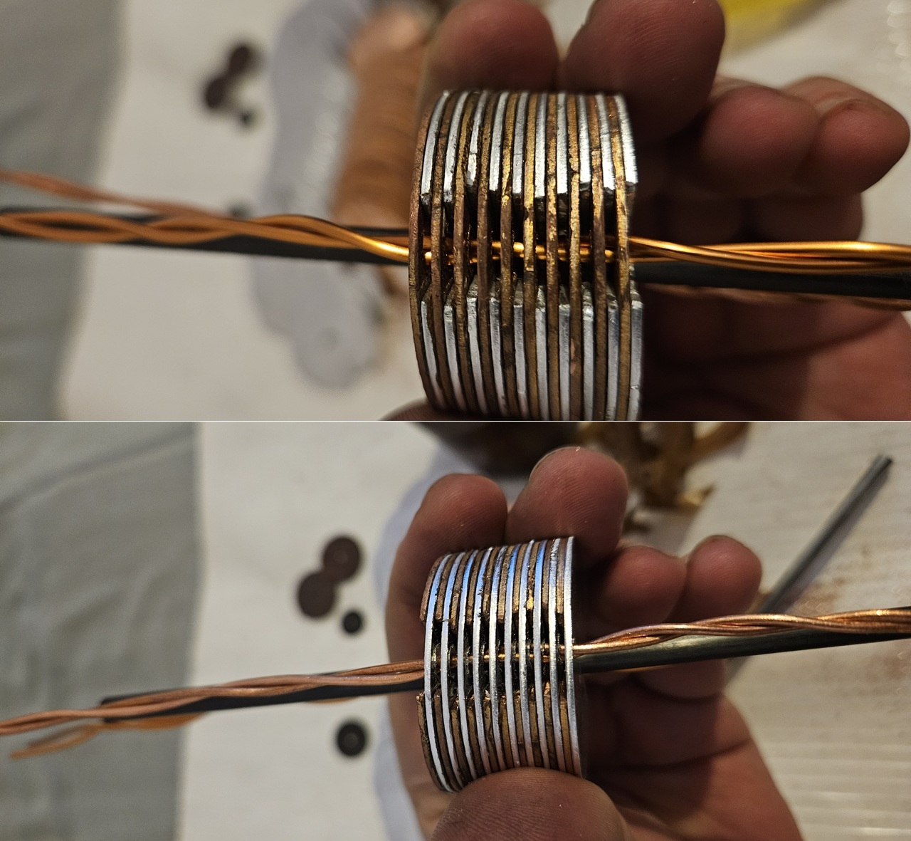

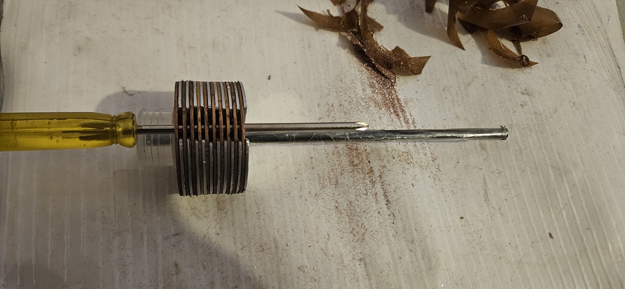

This is how a segment of the customized capacitor looks like:
Ignore the copper wires and the screwdriver, I'm using them to make sure the holes I make in the disks are aligning with each other.
Note: the carbon fiber tube is electrically conductive so I needed to add a few layers of scotch tape over it to stop it electrically connecting all the disks. The conductivity is expected but I didn't thought about that when I ordered them, I was thinking only about their mechanical strength.

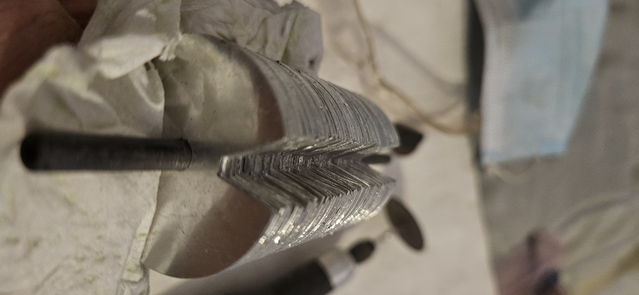

This is a close-up of the segment:

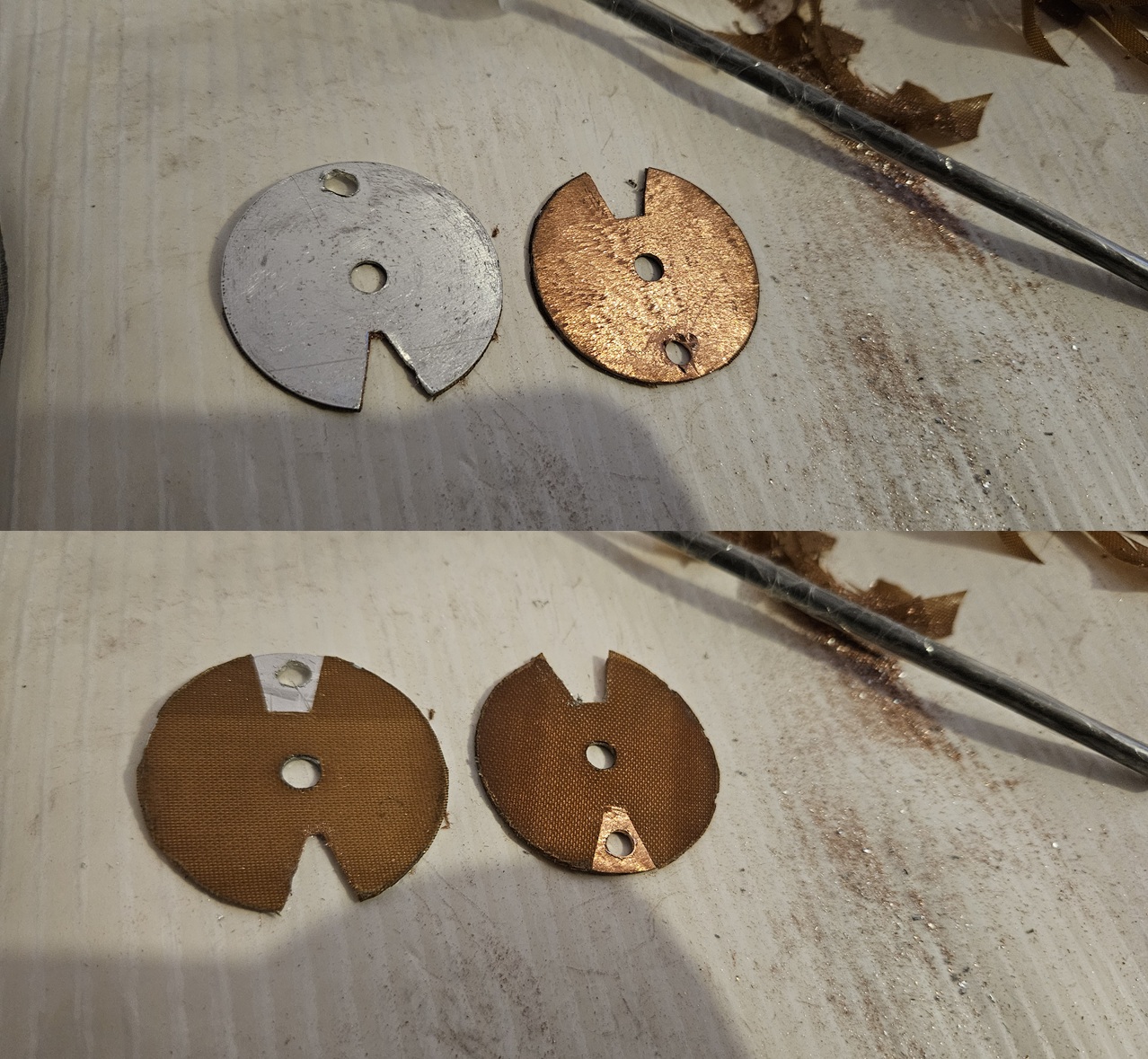

And here are two disks ready to be added to the assembly:
The process of preparing them is painfully slow, preparing two disks like in the image above take about one hour including cutting the teflon sheet for each of them.
It's really testing my patience a lot.
But I must work very carefully to make sure there will be no electrical contact between the copper and aluminum disks.
Drilling the holes in the aluminum disks is easy but the copper disks are again difficult to work with, my drilling bits are very ineffective. It takes 20-25 minutes of work to drill a hole in a copper disk.

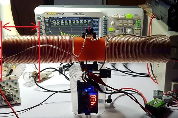

This is the current status. Very slow progress but I'm still progressing:
The current length is about half of the left part of DSE's coil:
